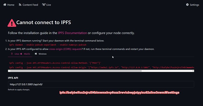

Some people might try to visit IPSM using the ipfs facility integrated into Brave Browser. Could you please include instructions for how to adjust the necessary settings in Brave’s ipfs or ipfs-companion? (If you could add some screenshots or even create a video gif, maybe using sharex or something similar, that would be great!)
It was on purpose!
Brave having IPFS integrated is awesome BUT it’s very hard to configure it without fucking up (and if you do, IPFS in brave will no longer work at all yikes!).
It’s sad but until they fix it somehow I’m not going that route.
@SionoiS - What about people who have only installed ipfs-desktop? How might they try?
@yeehi
See here
Use at your own risk it’s not really tested much.
Thanks, I had a quick try testing it and couldn’t get it to install. Might this be packaged as an AppImage or .deb?
IDK maybe but your still asking a user to install IPFS.
The best would be browser integrated IPFS with a nice API. I’m sure one day…
