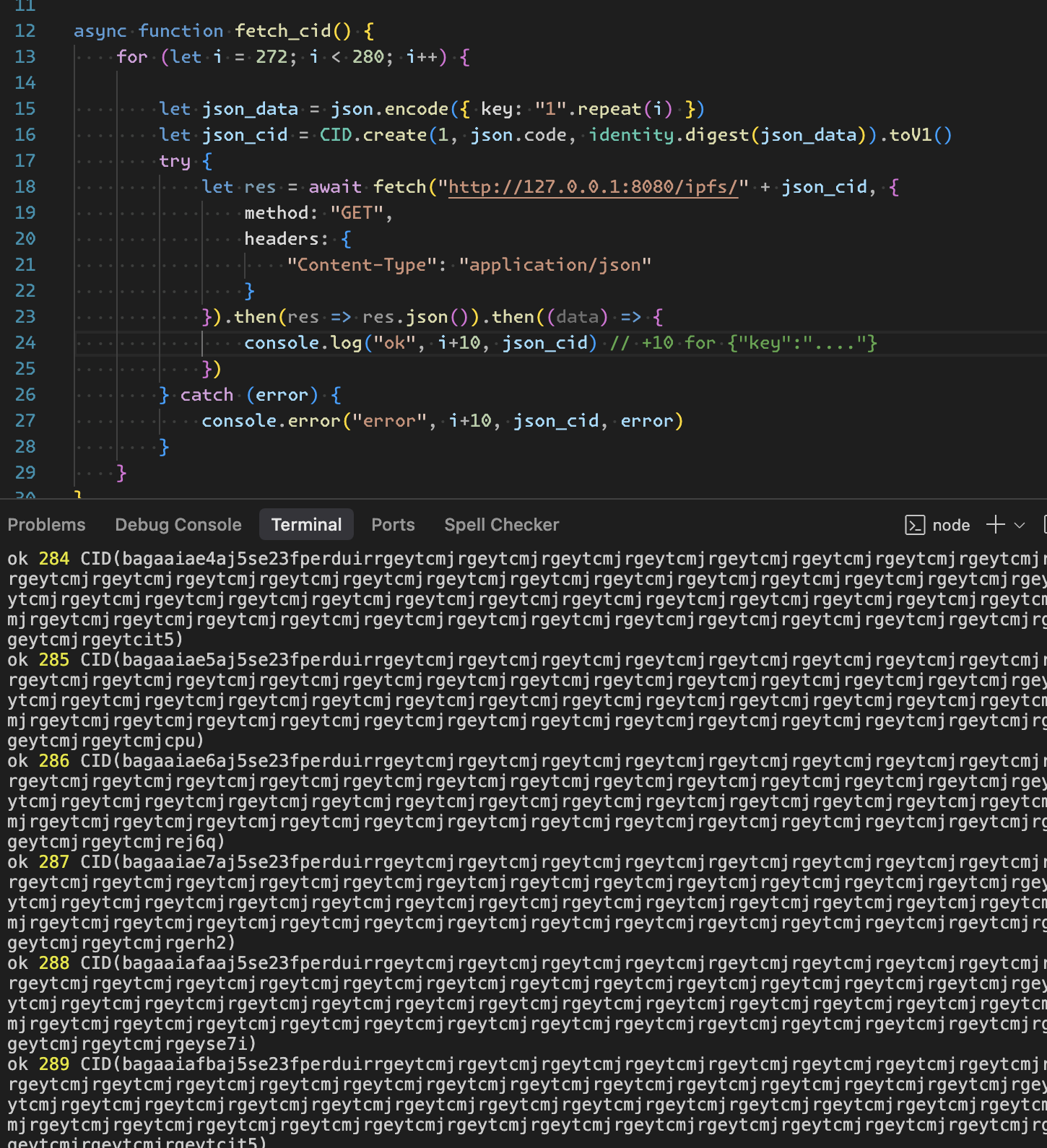

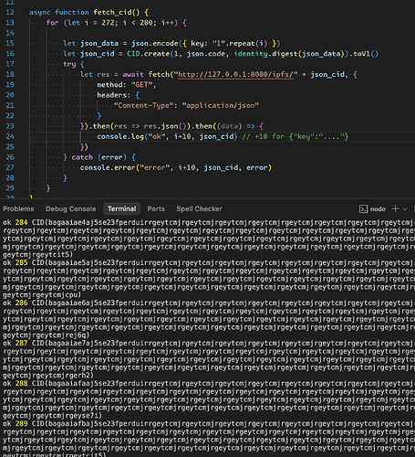

Yes, we’re using both inlining and multihashed approach to support dynamic/onchain cidv1. Actual use case would provide both versions as ens contenthash and text records so standalone pinning service can read and pin that long raw data into multihashed ones, but it’s not suitable for more dynamic onchain data updated every block/use case.. Also, we use inline cidv1 to mix offchain pinned ipfs cids with onchain data using dag-cbor link tag.

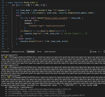

Looks like that’s case for ipfs.io, it stops resolving after cidv1(base32) length > 463 with 285 utf-8 chars in raw data.. But same longer cids resolve with local 127.0.0.1:8080 path gateway running Kubo v0.35.0
we’ve base16 cids and CAR files in test dir.
RFC 4408 deals with concatenating multiple TXT records for longer SPF entries, but DNS label limits (63 characters per label, 253 total for FQDN) seem to be a separate constraint of the DNS system.
Could you clarify how ENS is using RFC 4408 techniques to address the DNS label length issue? Or did you mean TXT values and not DNS labels?
I was able to reproduce problem you describe.
Took the longest sample CID from dag-cbor-test-data.sol and prepended f to it to make it base16 CIDv1. Opening it locally works fine, but indeed, the URL https://ipfs.io/ipfs/f0171008206a663726177d82a5892000171008c01a36a7368613235362e747874d82a58250001551220a591a6d40bf420404a011733cfb7b190d62c65bf0bcda32b57b277d9ad9f146e6c6964656e746974792e747874d82a50000155000b48656c6c6f20576f726c646d6b656363616b3235362e747874d82a58250001551b20592fa743889fc7f92ac2a37bb1f5ba1daf2a5c84741ca0e0061d243a2e6707ba646a736f6ed82a589e000171009801a36b7368613235362e6a736f6ed82a582600018004122065a4c4ca5acfc4bf3b34e138c808730f6c9ce141a4c6b889a9345e66c9739d736d6964656e746974792e6a736f6ed82a570001800400117b2248656c6c6f223a22576f726c64227d6e6b656363616b3235362e6a736f6ed82a5826000180041b20068cd05557eb0a2358c3fab33bcecc929f0b4f01caed8562f772bbeb8869eec9666e6573746564d82a59014800017100c202a263726177d82a5892000171008c01a36a7368613235362e747874d82a58250001551220a591a6d40bf420404a011733cfb7b190d62c65bf0bcda32b57b277d9ad9f146e6c6964656e746974792e747874d82a50000155000b48656c6c6f20576f726c646d6b656363616b3235362e747874d82a58250001551b20592fa743889fc7f92ac2a37bb1f5ba1daf2a5c84741ca0e0061d243a2e6707ba646a736f6ed82a589e000171009801a36b7368613235362e6a736f6ed82a582600018004122065a4c4ca5acfc4bf3b34e138c808730f6c9ce141a4c6b889a9345e66c9739d736d6964656e746974792e6a736f6ed82a570001800400117b2248656c6c6f223a22576f726c64227d6e6b656363616b3235362e6a736f6ed82a5826000180041b20068cd05557eb0a2358c3fab33bcecc929f0b4f01caed8562f772bbeb8869eec96a696e6465782e68746d6cd82a581900015500143c68313e48656c6c6f20576f726c643c2f68313e6a726561646d652e747874d82a50000155000b48656c6c6f20576f726c646b636f6e6669672e6a736f6ed82a570001800400117b2248656c6c6f223a22576f726c64227d produces HTTP 502.
I’ve confirmed the Error 502 is produced by NGINX and not IPFS backend (Rainbow), but I’m hesitant investigating further, as the use case looks like a misuse of identity multihashes which should be only used for small data leaves (see questions below).
