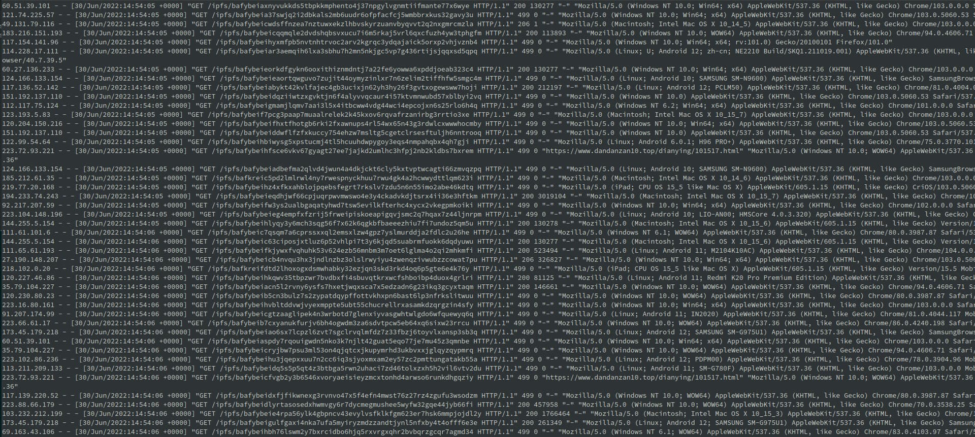

I’m also observing lots of peers hitting my node recently, pushing it up to 100% CPU and filling up disks after some hours. This started around June 26th. Currently I’m connected to ~2500-3000 peers. Garbage collection is active but doesn’t kick in, trying with a lower gc watermark now.
So, maybe I’m wrong but to me this looks like a spam attack…

If you’re running a public full gateway (IE: Not just restricted to CIDs / keys you control), extremely high usage is to be expected, and completely normal. It’s not necessarily spam, but it could be someone or some people pointing to your gateway to retrieve their IPFS data over HTTP.
well, agreed on that but actually those cids are looking highy suspicious for a public gateway (if it’d be normal traffic I’d expect to see some CIDv0s in them) + as said, the clients all close their connection before the gatway responds. I’m running this machine since February and today morning traffic suddenly skyrocketed. Could be that someone decided to publish that gateway’s hostname on some public list but for me the traffic looks highly suspicious.
You could always check what data is inside of the CIDs. I’m betting the same thing as you, your gateway got published somewhere, and an application is using your gateway on the regular as a default now (hence the consistency in CID type).
checked ~10 requests, they’re all leading to binary content, nearly all of them start with bafybei / base32 dag-pb. Wondering if that’s maybe the Ceramic network :thinking: I’m not using that node for ceramic (did so on the same instance 1y ago but this is a new instance)
So this is cool, I checked one of the URLs that was attached to one of the requests. Seems this website might be using your gateway as one of their hardcoded gateways: https://www.dandanzan10.top. In short, your high volume of traffic and binary is likely video content.
Yeah, https://www.dandanzan10.top/ has has the following IPFS gateways hardcoded in its JS:

Do we have any public block lists for urls that abuse?
uh wow, my machine is no 2 on that list :joy:
