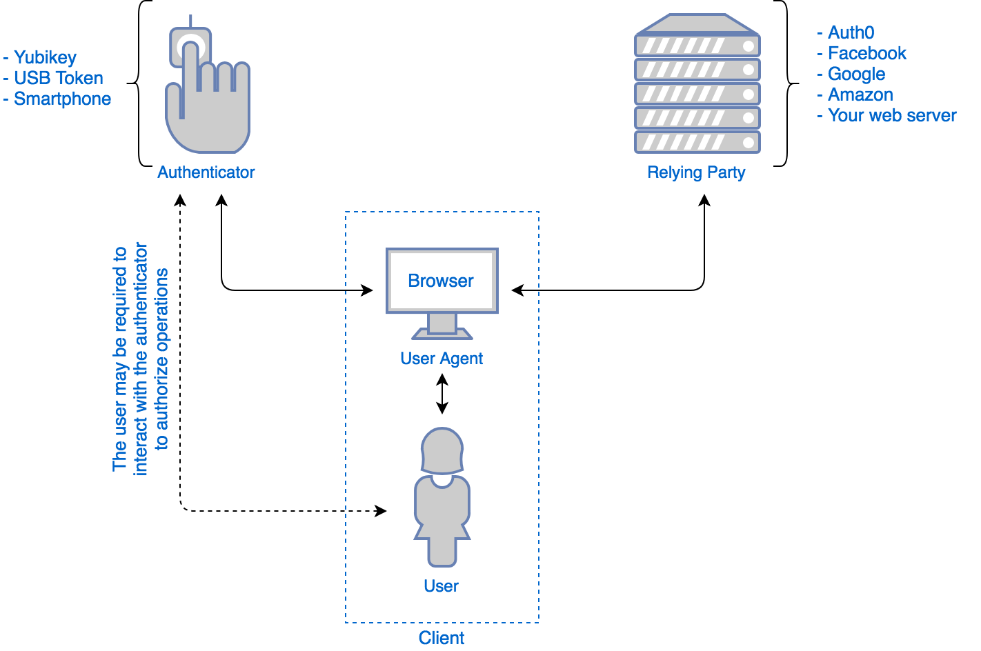

A flow of how it establishes that fact is represented in the image below (stolen from here, read it for a much more in depth article about what WebAuthn is)
As you can see in the image, there is a connection with some service (a relaying party) that hands you a challenge to solve. Overly simplified, if your device returns an answer that can be verified by your public key then you’ve proven to be who you claim you are and are logged in.
If you were to make a website you need to have something running that verifies who you claim you are. You need to have a “relaying party” on your server that takes care of that for you. Now this is where i see some issues with IPFS in it’s current form and this authentication method. This simply cannot be done. Yet. Right?
