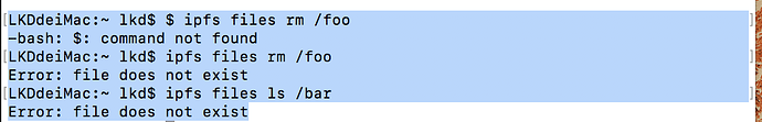

Error when removing files!
when I remove files using the command "ipfs files rm ",there is always error.
Please help me. Thanks.
If you do ipfs files ls / can you see the foo file or bar file? Might be that you just haven’t created those files yet.
I have already created them.And I can find them .

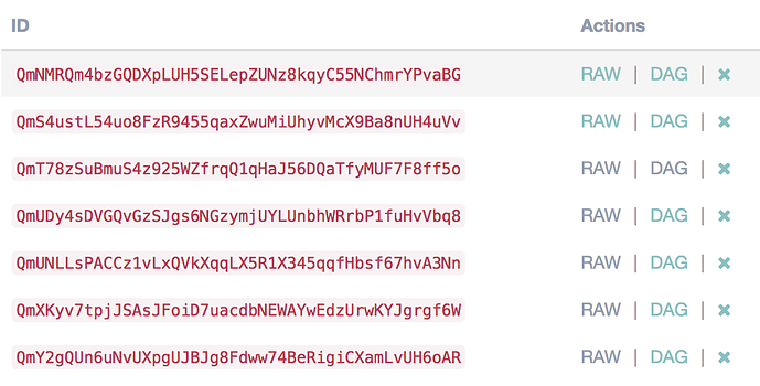

I have created the files and added them as the quick-start teaches. The add command also returned hashes. Why always say “File does not exist”? Another Question
I did not delete the files when clicking the cross.
when you click on croos i think you unpin this hash. a think you lost you can retrive you file if you use hash and no filename.

Is there mistake with my actions?
try ipfs files rm -r foo ?
There is no merkledag. I don’t know why.
yes it’s weird. you path seems not present on your dht :frowning:
ok could you try that
