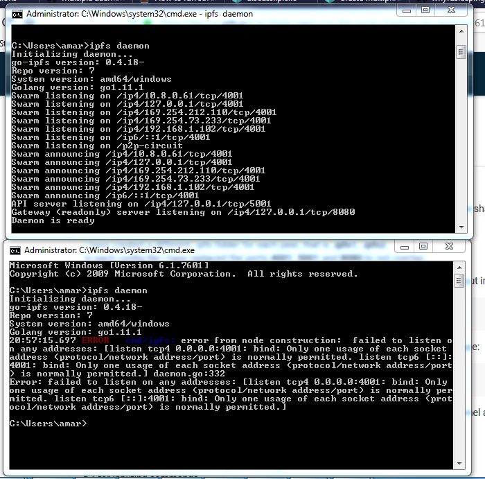

UPDATE
I did the following:
opened two cmd windows
and seperately execute set path
set IPFS_PATH=C:\Users\amar.ipfs2
and seems created the second instance successfully
in the second window I executed
ipfs daemon I got this error
2nd UPDATE…
seems it is getting clear now… just in case someone get the same issues it is clear now…
I modified the original config by changing the address of both: swarm , api, and gateway .and give them different ports and the two nodes runs successfully
