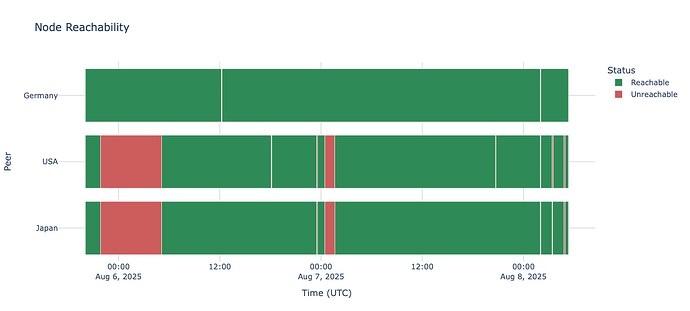

The plot above displays a timeline of each peer’s reachability status. A peer is considered unreachable when either a) the find peer-info operation fails to return a list of multi-addresses for the peer, or b) no entry exists for that peer during Akai’s visit.
The first restart cycles for the US and Japan peers was done on the 5th of Aug 2025 at 21:51 UTC to the 6th of Aug 2025 at 5:02 UTC.
Peers are removed from the peer store almost immediately after disconnection. Rediscovery occurs relatively quickly: approximately 5 minutes after restart for the US peer and 3 minutes after restart for the Japan peer.

The second restart cycle happened on the 6th of August 2025 between 23:29 UTC and 23:35 UTC.
The peer store removes the disconnected peer almost immediately. Rediscovery happens significantly faster, at only a minute after reconnection, compared to the first restart cycle. This is expected behavior as IPFS refreshes the routing table every 10 minutes.

The third restart cycle was longer than the second but shorter than the first. The motivation was to observe whether the length of time that a peer is not in the network would influence the time it would take to add it back to the peer store. The peers were shut down on the 7th of Aug 2025 at 00:28 UTC and restarted on the 7th of Aug 2025 at 01:37 UTC.
Interestingly, the US peer was re-added almost immediately, becoming reachable during the visit round on August 7, 2025 at 01:38 UTC. In contrast, the Japan peer did not appear in the peer store until the visit round at 01:40 UTC, consistent with results from the previous restart cycle.

During the fourth restart cycle, both peers were shut down on August 8, 2025 at 03:24 UTC and restarted just three minutes later at 03:27 UTC. The Japan peer became reachable almost immediately after restart, while the US peer took about four minutes to become reachable. This behavior contrasts with what we observed in the third restart cycle.
During the fifth restart cycle (August 8, 2025 at 4:46 UTC to 4:55 UTC), both peers disconnected and reconnected almost immediately.
The US peer taking longer to become reachable might be a consequence of timing relative to the DHT’s 10-minute refresh cycle.
