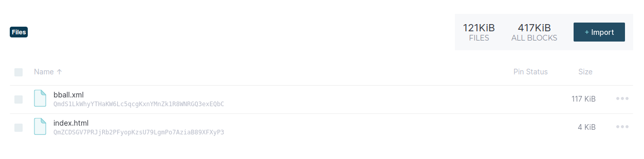

I’m using the links I get from “Share link” option in the three dots to the right of each file in the IPFS Desktop Files section:
https://ipfs.io/ipfs/QmdS1LkWhyYTHaKW6Lc5qcgKxnYMnZk1R8WNRGQ3exEQbC?filename=bball.xml
https://ipfs.io/ipfs/QmXp1jP63UJZhfTkxYuMyJ8773CdE2s6zJF5jmSuM4is1U?filename=Files.png
Regards,
VG
These files are brand new (no updates). I can see peers in my network all the time.
From the three dots menu in Files, I can “Explore” the files and there I find some more information and two links, “View on Local Gateway” and “View on Public Gateway”:
The link for the local gateway works. The link to the public gateway doesn’t.
