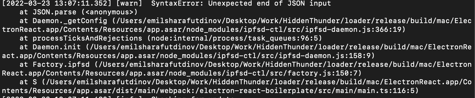

I’m spinning up an ipfsd-ctl server and connecting to it with single controller.
Also I established “remote” option to false.
And I keep getting error
With “remote” option to true I have another issues with “Bad Requests” for Http.
Any thought?
Btw, this error occurs only in production env.
Everything works perfectly fine in dev env.

After nodeIntegraion: true I got another issue, which is here:
Okay, it seems I solved it
This screenshot is from ipfs-desktop repo. Here you can see what ipfsBin path should be
Without this, I think this problem is pretty much unsolvable
