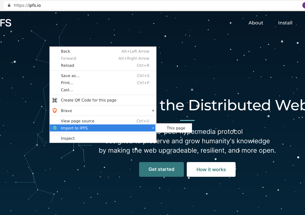

I think that would be great. If people could easily and cheaply pin content they find on the internet on their own computer, it could become a habit and culture.
The thing to do is make it “one click”, so easy that it is as effortless as using Big Data solutions.
